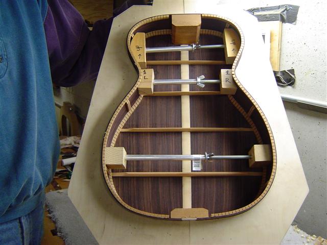

I also leave my spreaders in until the top and back are on. Here is a shot of the set up.

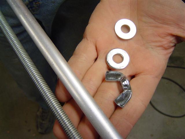

You can make the spreaders with aluminum tubing and threaded rodes with a wingnut and a couple of washers

I like those because they're as neat as a pin. Is that threaded rod actually
an acme thread, or is the pic playing tricks on me?
Craig S.
PostPosted: Thu Apr 27, 2006 6:11 am
Robbie those are slick, and I like it better than turnbuckles. Where do you acquire the aluminum tube?
PostPosted: Thu Apr 27, 2006 6:16 am
Posts: 2354
You can get the materials to build these here high tech luthier spreading devices (threaded rods and aluminum tubing)(3/8 inch standard rods and 1/2 inch tubes) at your local luthier supply warehouse (aka Home Depot or lowes)
